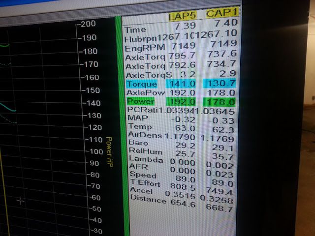

re tuned my hatch put on a stock ported intake manifold, stock ported throttle body that's it did the intake manifold change in the middle of the dyno session so it wasn't a different day or anything was within an hour of the last dyno pull
motor has compression test of 175 155 145 165 and leakdown about 20-30% between all 4 Sad
started off at 178whp mind you, this was on a street tune, i wasnt ready to put the car on the dyno yet because i wanted to do some more mods before i wanted to just hit 200whp lol
but you can see on the dyno i gained 4whp just by adding some timing fuel was tuned to 13.0 afr which i only had to clean up a little by adding timing
then i changed the intake manifold left timing where it was at and adjusted fuel to keep it at 13.0afr Smile 10whp gain
heres a before and after of the hp from 178 to 192 Smile car feels alot better now not bad for an old tired motor Smile
finished off at 192whp 163tq Smile

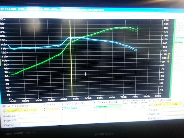

dallas.. the manifold change went from an usdm oem h22 intake manifold and throttle body to a oem usdm ported intake manifold and throttle body that came off a race car from 1998 from myles bautista i was suprised this old manifold made 10whp
put an rmf drag header on and wasnt that happy about the midrange, it lost quite a bit but what can i expect its a drag header and it makes power where i want and holds the tq curve up alot longer then my old modified dc header..
heres the dyno graph.. 199hp 150tq if you look you can see it lost about 20hp midrange Sad but honestly i cant really even feel the difference
