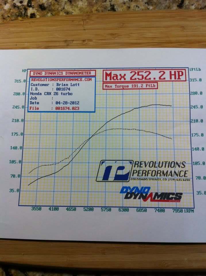

Finally got the turbo in. GO-Autoworks street x, cast mani, D16z6, vitara 75.5, mild port, delta 272-2, super tech springs, omni 4bar, Rc550's, Bullseye s252 batmowheel, 3" down pipe 3"thermal R&D. This is at 6000' -total boost was 16psi, my gauge reads 13psi.(-3psi with engine off). (3rd gear roll, on the street, I hit full boost at 4700rpm)
didn't have time to adjust the cam, conservative tune-will be back to further tune with meth. (uploaded map)
