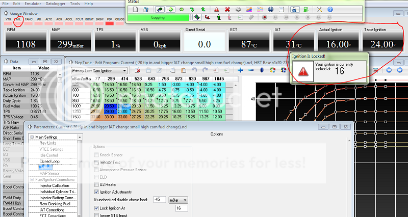

Coupe-r Wed Apr 03, 2019 8:12 am
ok I finally bench tested this today, because few of my customers were complaining it wasn't working.
Confirmed service check connector input Pin D4 on the ECU does NOT lock the timing using Neptune maps. It does however disable ignition adjustments (like idle control ignition advance/retard) This is with service check connector function as normal (not re-purposed for another input)
it certainly does not lock the timing to your set 16 degrees. ONLY timing lock in the software works, meaning chip based end users have no way of locking and setting their own timing.
Check light off shown below (table timing 24, actual 20.75 when I would expect 19.25 actual?
(24 table - 5.25 idle error + 0.50 RPM based ignition adjustment =19.25 degrees) But thats getting off track for this question about timing lock.
Service check connection enabled (ONLY ignition adjustments active NOT locked to 16)
Finally using Neptune timing lock gets me to 16 degrees

HRTuning Wed Apr 03, 2019 9:22 pm
Actually, you raising the idle to outside of where ignition would be 16.5 is why it's not locked at 16. As you'll notice from your photos it does lock timing to what's in the table (See photo 1 vs photo 2), which would be 16 from the factory at factory idle. Feel free to adjust the ignition table to appropriately be 16.5 in the idle area if you'd like it to lock to 16.5 when jumped.
There's more than just idle ignition adjustments at play, which should make apparent why it's not table-idle adjustment only during normal operation.
