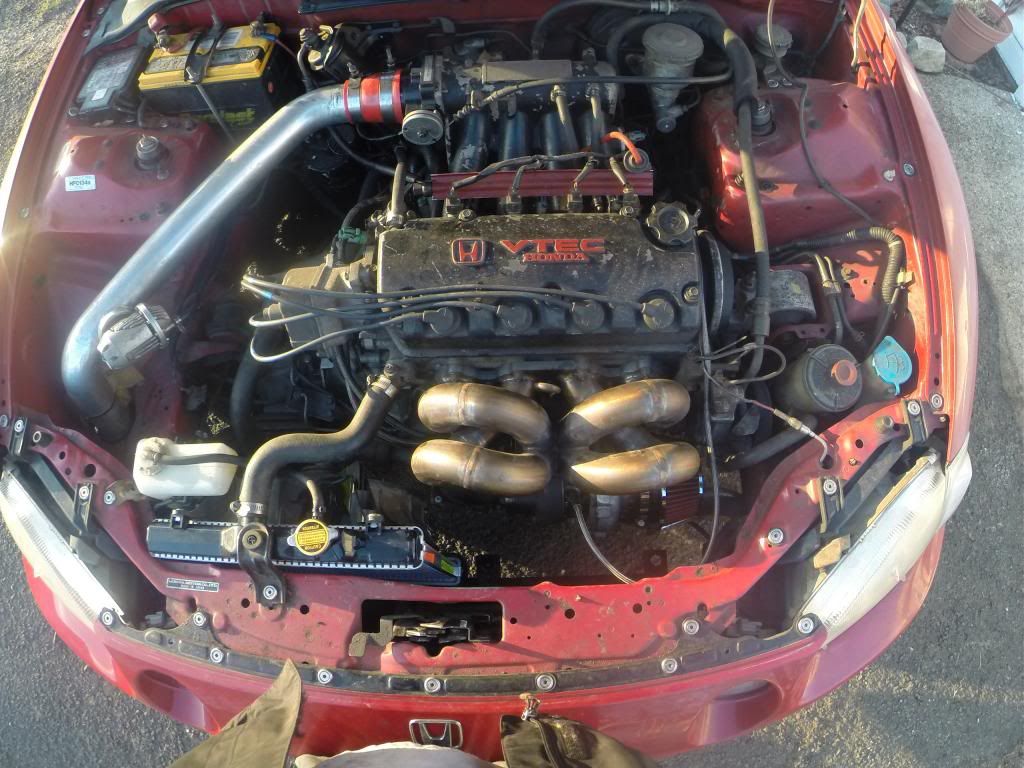

Car is used mostly for Autox. Wanted a quick spooling turbo with mimimal lag may upgrade to the gtx turbo after I clean up a few things.
d16z6 stock head

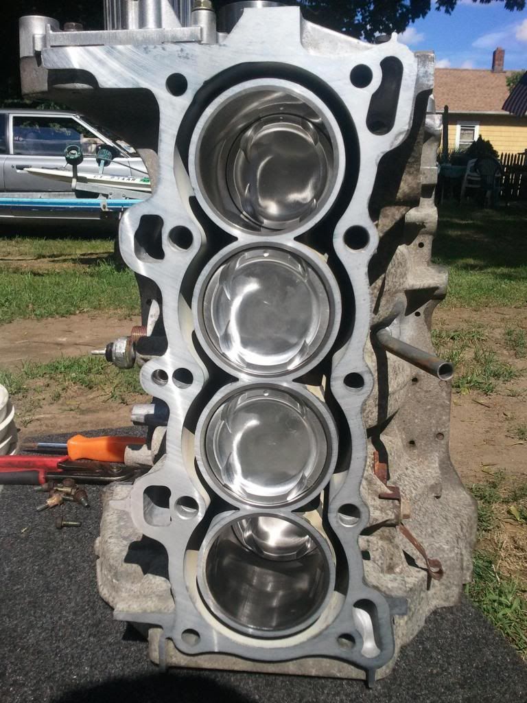

76.5mm weisco pistons around 8.5-9.0 compression Compression test 130psi across the board
eagle rods
440 injectors
Skunk2 throttle body (68mm)
Skunk2 intake manifold (bored to 68mm)
Doc Race Mini Ram
garrett gt2860rs .64 exh housing internal wastegate
junk downpipe maybe 2' (really holding the power back)
255 walbro fuel pump
hondata 4bar map sensor
PWM boost controller Port 1 open, Port 2 to wastegate, and Port 3 to vac source
P28 Chipped ECU with PWM boost controller on Neptune RTP
[/URL]

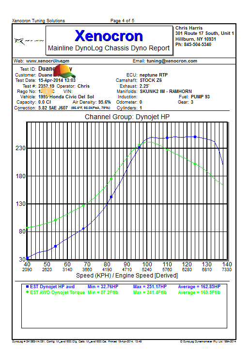

boostenthatsol63 Wed Jul 02, 2014 2:33 am
Here is my old setup on a stock d15b vtec 10psi with a gt2854r with the same bolt ons so the curve should be close to this when I fix my downpipe.
