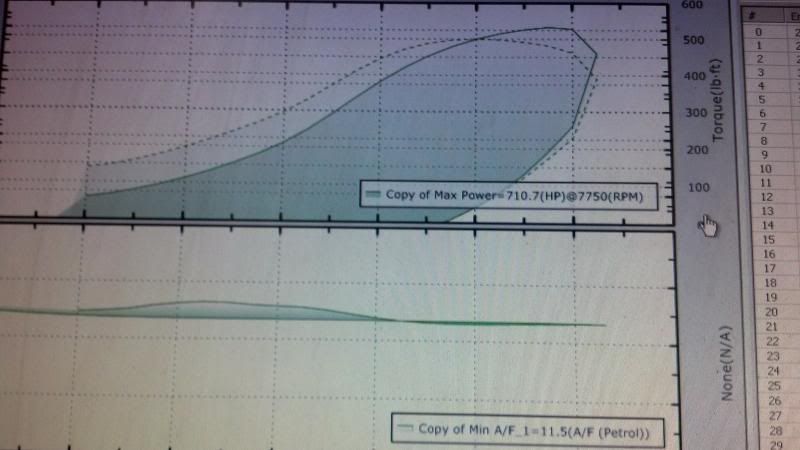

Just thought id share my Neptune'd car.
Some specs...
94 teg RS
GE B18A1
B16 stock port head
8.5 to 1 Wiseco slugs
Eagle rods
Skunk 2 Pro 1 cams
Supertech valves, spring retainers
Homemade turbo using a 37R center section/shaft/exhaust wheel, .82 housing and on the cold side using a Precision 62mm Billet wheel, back plate and ported compressor housing. I like to call it the 6237R lol.
Topmount with Precision 66mm wastegate
Precision A2W PT1000 cooler with a 5 gallon water tank
Fuel is E85 using ID2000's
Aeromotove A1000 pump
Sumped tank
Neptune for management lol.
Ended up maxing out he boost controller at 33lbs and came away with 710whp and 500wtq.
And it made power up to 9000, for some reason on that pull the graph on the computer was off once we deleted some other runs.
