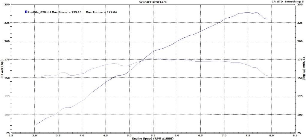

H22A 239 WHP 177 LB/FT
Dellas Thu Jun 02, 2011 7:04 pm
H22A
Wiseco 11.5:1 CR Pistons
Eagle Rods
Skunk2 Cams
Skunk2 Cam Gears
Intake
Custom Header
No exhaust
Pump Gas
Neptune
239 WHP 177 LB/FT
We were expecting a little more power but we discovered a couple days later that the block and head were warped slightly causing the car to overheat after being thrashed on continuously.
