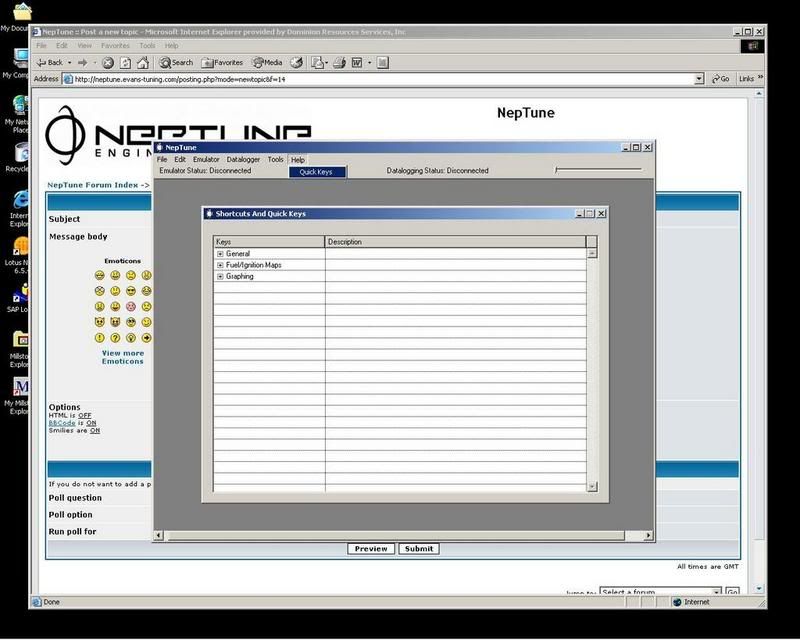

First off these Quick Keys can be found in the NepTune RTP software.
They can be found by opening NepTune RTP.exe
Next click Help> Quick Keys
